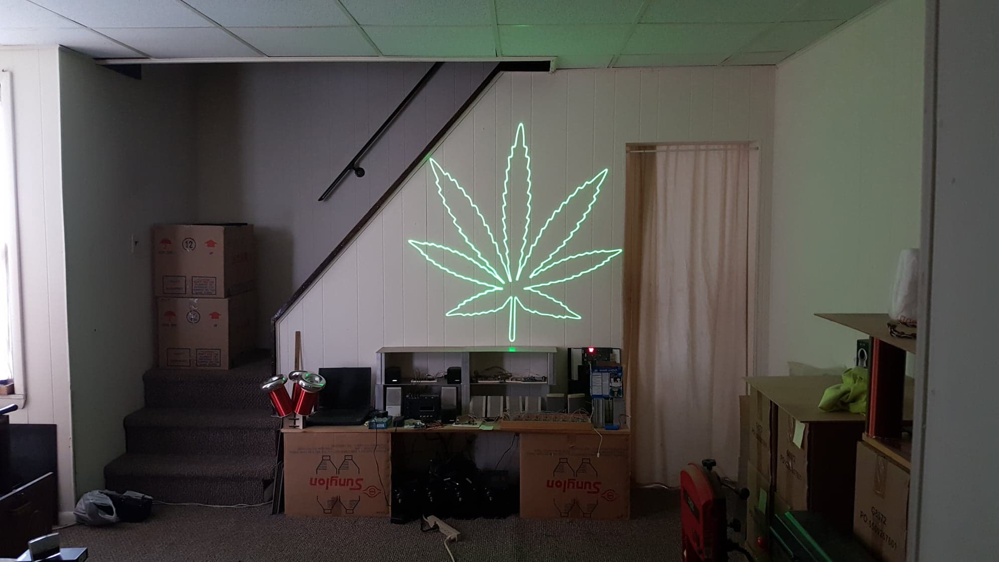

Not appropriate for all audiences, but this is probably one of my favortite things I did with your code.
https://www.teslaunderground.com/uploads/GreenLeaf.jpg
Rich
